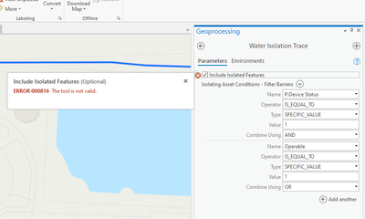

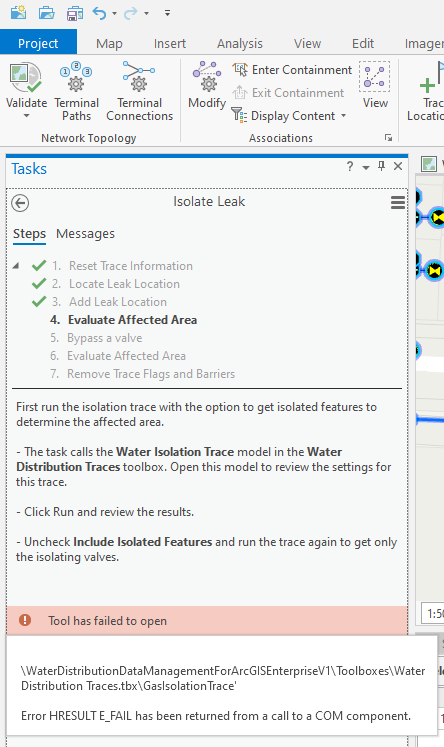

Hi, I am trying to go through the tasks coming together with the water solution. Following error poped up at the Isolate Leak task. When I open the Water Isolation Trace tool from toolbox and there is still an error. Please kindly help.
The software environment is ArcgisPro2.7. The asset package model version is 4. arcpy is 2.7.  

It looks like the task was incorrectly set to the wrong model, you can use the task designer to set it to the model in the Water Traces toolbox.
Song_Li

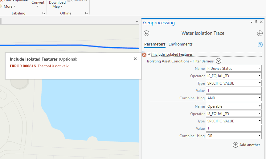

Thanks Mike, this solves the problem in the first figure, but the error message in the second figure remains.

I would open the model and ensure it can find the utility network.
Song_Li
Thank you again, I opened the model and found the error sign. I don't see any documentation on this model, so not sure how to fix it. there is no drop-down option for the Network Utility Network(3). any suggestion on how to fix it?
