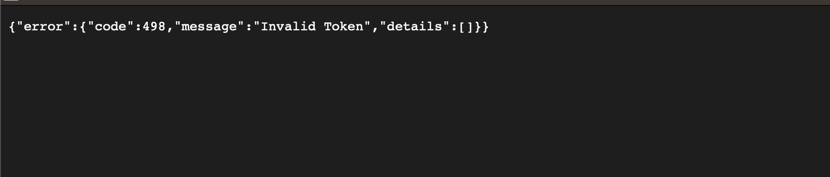

When accessing the FeatureServer /layers endpoint for listing the layers of a given feature server (e.g  https://<<www.somefancydomain.com>>/server/rest/services/Electric_Utility_Network/FeatureServer/layers?token=<<my_secret_token>>&f=json) using a token generated through portal /generateToken endpoint (e.g. https://<<www.somefancydomain.com>>/portal/sharing/rest/generateToken), the result is "Invalid Token" (tested with several different credentials, all of them with valid ArcGIS Utility Network licenses). The behavior happens no matter how we pass the token in the request - I tried using querystring, authorization bearer header, and X-Esri-Authorization header and it fails every time.

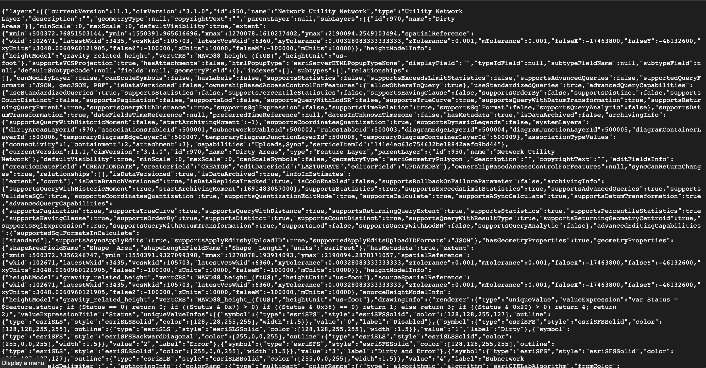

IMPORTANT: The behavior only happens if we set the Client parameter of the Generate Token endpoint as "IP Address" (in this case, I did use my public IP Address) or "IP Address of this request's origin". If we use the "Webapp URL" option instead and set a domain there, even a made-up one, then everything works as expected.
I was able to reproduce the same behavior using different clients like the browser, postman, curl, python, and javascript requests.I'm not sure if this is the expected behavior, but it didn't make much sense to me.

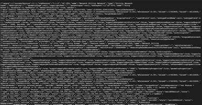

========================================================================ReqRequest with token generate using "IP Address of this request's origin":
Exact same request but token was obtained using a made up url in the "Webapp URL" parameter:
