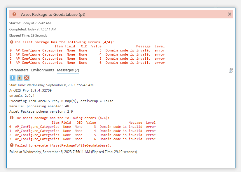

Hi all,
When running the Asset Package to Geodatabase tool (or apply asset package), I'm receiving an error that the  values 3, 4, 5, & 6 are invalid for the AP_Configure_Categories domain. This is a domain that comes with the Stormwater Utility Network Foundation solution and it has not been edited.
I'm not using this domain for the D_Configurations table - is it safe to edit or delete this domain? Any ideas why it would be giving errors with seemingly valid domain code values? Thanks in advance!

Those were added in a newer version of the untools. Can you post what version of the untools you have
TobeyKane-Seitz
Hi Mike - 2.9.4
TobeyKane-Seitz
Updating to 2.9.7 worked - can you explain what the relationship is between the untools version and that domain?

Those new codes where added for additional functionality in the config table.  Only the new untools know how to use them.
