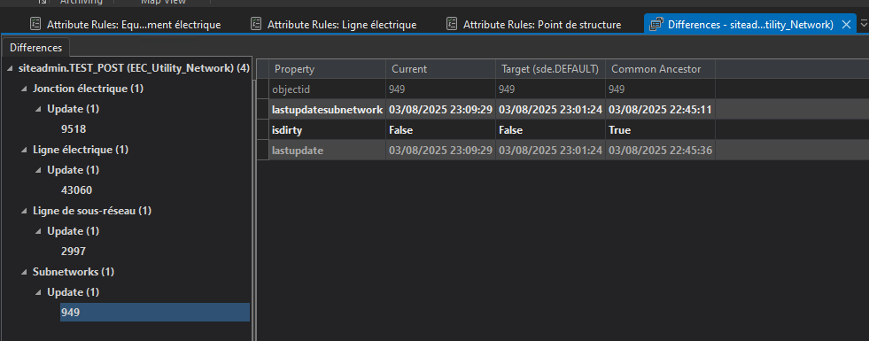

The standard workflow is to edit features in a version and, when needed, to update subnetworks. This will trigger some attribute rules in the version. Then to reconcile and post to default.

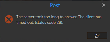

When editing features and posting, without updating subnetworks, the Post time is good. Example : move a vertex in a LV cable --> post in ~20 seconds
However, as long as I update the subnetwork, the post time increases greatly, often causing a client-side timeout after 10 minutes.
Same example with only 1 vertex moved, and LV subnet updated --> mode than 10 minutes for a total of 4 changes in the version

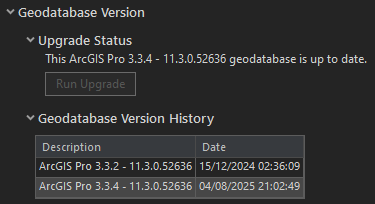

After some testing, I discovered that the geodatabase version was causing the problem.
The geodatabase was originally created with ArcGIS Pro 3.3.2. After upgrading to 3.3.4, the time to publish changes became more reasonable (between two seconds and a few minutes maximum, depending on the number of changes).
With the help of Robert Krisher, we identified at least two bugs that could be causing the problem:
https://support.esri.com/en-us/bug/registering-a-class-as-branch-versioned-is-not-creating-bug-00017...
https://support.esri.com/en-us/bug/unable-to-reconcile-or-post-branch-versioned-data-conta-bug-00017...
