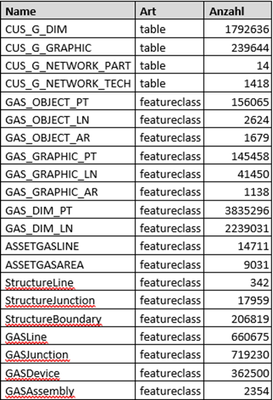

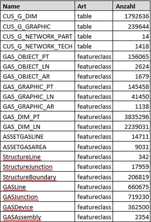

Here is an overview of the amount of data we are currently trying to load into the UN:
During the overall migration, many times the number of objects shown above will need to be transferred.
The software currently in use can be found in the attached log file. As you can see from this, the loading process for the GASLine feature class has stalled and has not yet been completed. No GASLine objects have arrived in the database yet. GASDevice had a loading time of over 6 hours, while GASJunction took over 7.5 hours (even though GASJunction has even more objects than GASLine).
