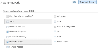

Prior to 10.8.1, if your Feature Service includes a UN Topology layer at the time of publishing, "Utility Network" capability is included and it includes "Validate Network Topology" operation. ArcGIS Pro simply calls this operation.
SSMIC3038
Thanks for the comments.
My feature service does show the same as your image, the validation capability is present although not checked (and can't be checked).
The feature service also lists the topology layers in the service properties.
