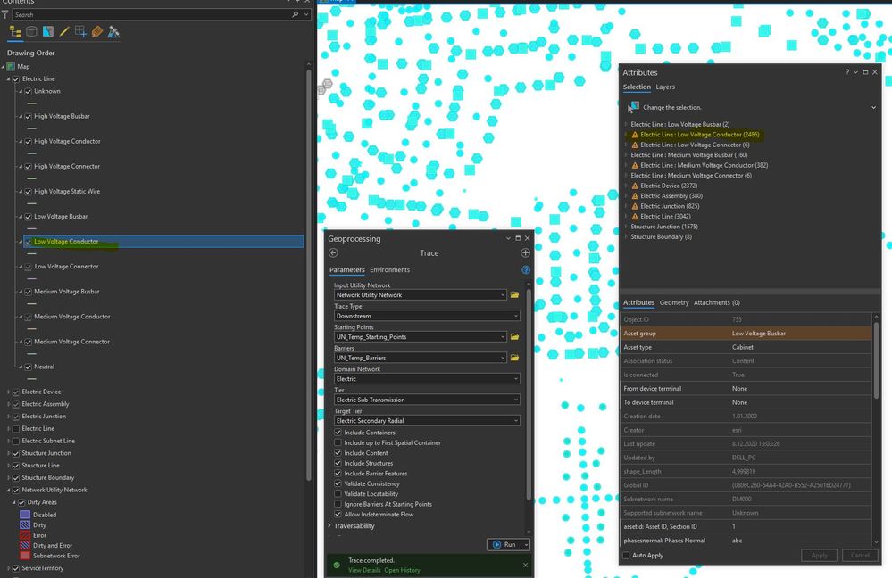

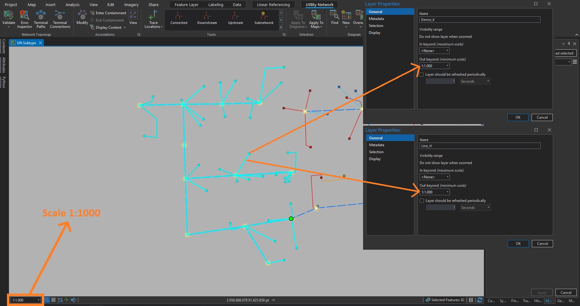

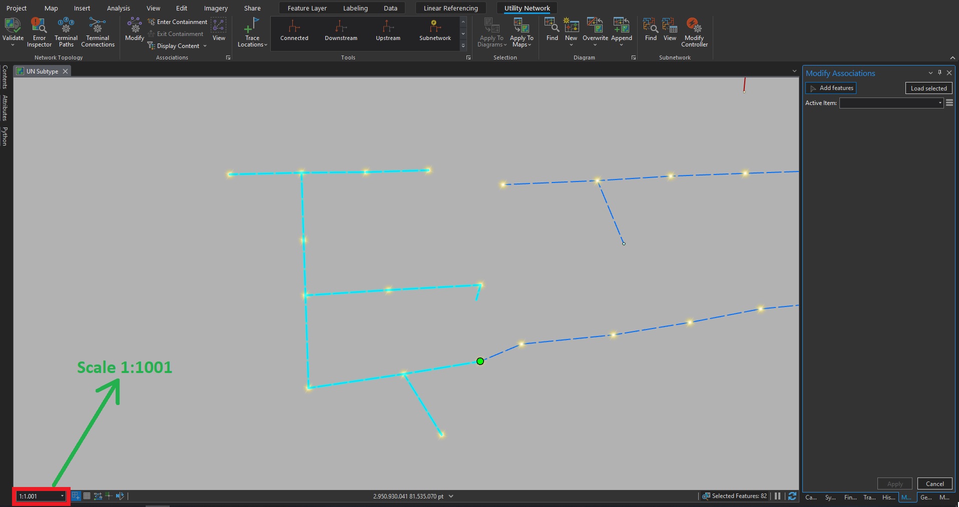

I have features with the visibility set to appear at 1/1000 scale.
I want the selected features to be displayed on the map regardless of scale as a result of a trace analysis.
How can I display the details in the trace results on a scale-independent map?  How can I do that?
