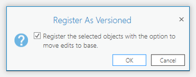

When registering the dataset containing the UN as versioned At any point did you see this dialog, and if so, do you select the check box and click OK (Note: this option is not supported for datasets like the UN)?

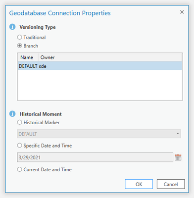

Can you confirm the Geodatabase Connection Properties for this particular database connection are now set to Branch as shown below?

"When registering the dataset containing the UN as versioned At any point did you see this dialog, and if so, do you select the check box and click OK (Note: this option is not supported for datasets like the UN)?"
No, this option is available when the traditional versioning option is active. I want to "register as versioned" the dataset when in the traditional versioning option.

 Hi @GIS_Solutions I still see that the geodatabase connection property is set to "Traditional" in the video (7-10 seconds in the video). You will need to have this set to Branch in order to register the utility network as versioned. Let us know if you can register as versioned after that.
