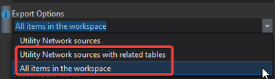

I used relationship classes in a mobile geodatabase, then exported them as an asset package and imported them into an enterprise geodatabase without errors.
Make sure you use the correct option in the asset package export toolbox, either the second or third:
