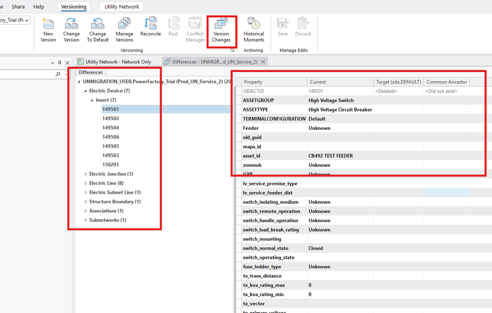

After 3.4 there is a "Version Changes" functionality that you can use to see the changes.
Here is an example from ArcGIS Pro 3.5 that shows the Version changes.
Hope that helps!
