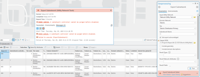

Can you include a snippet of your export from the ArcGIS API for Python, along with a screenshot of the same export using a GP tool.

So, after several tests, it appears that the error only occurs when the export_acknowledged parameter is True. I have been able to reproduce with arcpy and GPTool :
arcpy.un.ExportSubnetwork(
    in_utility_network="EEC Utility Network",
    domain_network="Electric",
    tier="Réseau HTA",
    subnetwork_name="GDN-837-07",
    export_acknowledged="ACKNOWLEDGE",
    out_json_file=r"C:\Temp\GDN-837-07.json",
    condition_barriers=None,
    function_barriers=None,
    include_barriers="INCLUDE_BARRIERS",
    traversability_scope="BOTH_JUNCTIONS_AND_EDGES",
    propagators=None,
    include_geometry="INCLUDE_GEOMETRY",
    result_types="CONTAINMENT_AND_ATTACHMENT_ASSOCIATIONS;CONNECTIVITY;FEATURES",
    result_network_attributes=None,
    result_fields=None,
    include_domain_descriptions="INCLUDE_DOMAIN_DESCRIPTIONS"
Error : https://pro.arcgis.com/en/pro-app/3.3/tool-reference/tool-errors-and-warnings/160001-170000/tool-err...
When setting export_acknowledged="NO_ACKNOWLEDGE" it works.

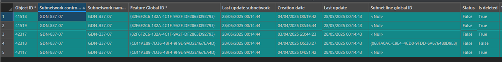

Here is the bonus subnet table where you can see there have been several subnetworks with the same name and controller, but only one is now active and clean :
