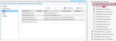

Hello @MikeMillerGIS , i have created geodatabase topology for this UNM and seem that it is working. Do you mean like I should not create topology on UN feature class? If I do, could it lead to some unforeseen consequences?

There will be some overhead in editing and validating since you have two sets of controllers each with different dirty areas, rules, and validations. You'll also want to be mindful of any restrictions to web/mobile workflows when using this dataset since you will be limited to the features of the dataset with the most restrictions in each case.
