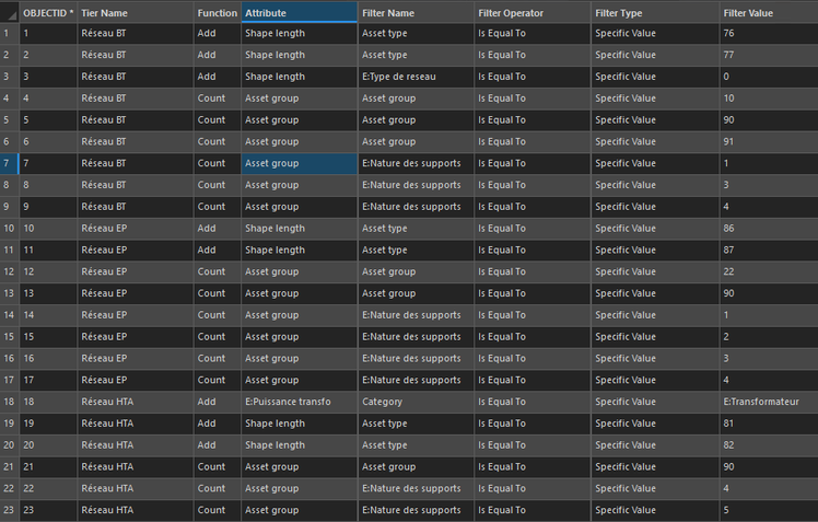

 My B_Subnetwork_Summaries looks fine :

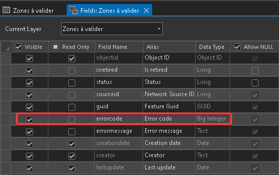

even when staging a v6 UN, I still have an incompatible field in the DirtyArea table
I get a warning when trying to share/overwrite my UN service :
https://pro.arcgis.com/en/pro-app/latest/help/sharing/analyzer-warning-messages/24170-value-contains...
Is this a known bug ?

I just created a new one in a FGDB with v6 selected and I do not see Big Int
