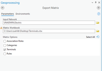

I'm sure there is a way to do this and I'm just missing it, but is there a way to export the assigned terminal configurations from a utility network?

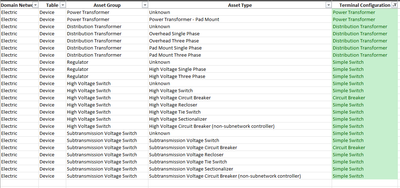

@EdwardBlair - You could use the "Export Matrix" Tool in the UDMS Toolbox (download here)
The output file looks something like this.
Hope that helps 🙂
Hope that helps 🙂
EdwardBlair
Hi gis_KIWI4!
This is just what I was looking for.  Thanks!
