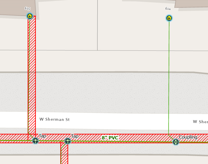

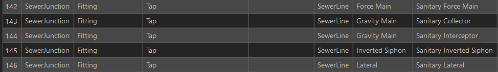

I am setting up a sewer utility network using the essentials foundation and adding attributes onto the data model. When I got to the enable topology stage all of my sewer laterals and sewer mains are shown as errors when they are connected by a tap. They do not have an error if connected by a different asset type like a coupling or if connected by a manhole (sewer device).  The junction- edge rule for taps look to be the same as for couplings so I don't understand why it is giving an error. I tried adding a edge-junction-edge rule but that did not get rid of the error. The sewer mains also allow for any vertex connectivity. Any ideas of what I am missing?

@TanyaWright1 - The first thing to check would be the connectivity rules but you've confirmed the rules exist.

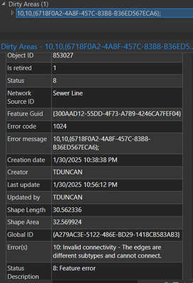

Hello, here is a snapshot of the error from the dirty area.

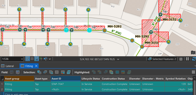

To add an update: I removed an existing tap and added a new tap and the dirty area went away. So it is recognizing the connectivity of new taps, but not the data I migrated over (which is geometrically correct). Any ideas why that could be or how to fix it?

I just tried adding a new tap between an existing lateral and main and it did not create an error. I then moved an existing tap off the lines and then snapped it back onto the lateral end point where it joins the main and it created the error.  So any new taps I create it is ok with but my existing tap data it doesn't like. The only difference I can see in attribution is the assetid and rotation are populated in my existing data.
