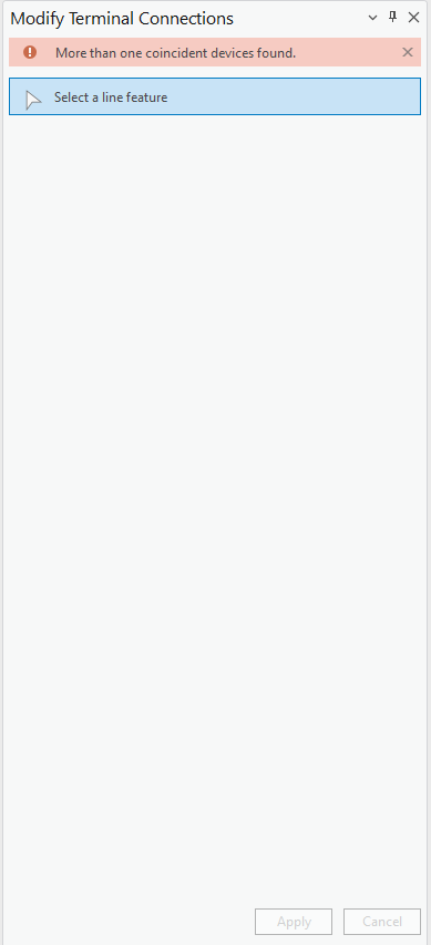

After upgrading to ArcGIS Pro 3.3 I am getting the following message when trying to set terminal connections with the Modify Terminal Connections. "More than one coincident devices found." On further investigation it appears to happen if you have the Utility Network Device layer multiple times in the map. Even when the device layer is disabled or has a definition query applied. This was a previous issue if you had multiple UN line layers in the map you would get an error if the top most layer wasn't the UN line layer. The issue with multiple UN line layers was resolved in 3.3 previous bug report linked below, however now having multiple device layers is causing an error. This is somewhat limiting as I have my edit maps setup to have the devices and other layers multiple times in the map to classify the data and help editors.
Previous Bug: https://support.esri.com/en-us/bug/in-arcgis-pro-the-attempt-to-modify-terminal-connection-bug-00016...
Workflow: Add Utility Network Device layer multiple times to the same UN editing map. Attempt to set a terminal connection with the Modify Terminal Connections. Returns "More than one coincident devices found." error.
Possible Workarounds: Use the new Snap Chip to set terminals on new line feature this will only work for new features being added. For existing features you could use the Attributes pane but need to know the proper terminal domain value to set on the line for the specific connected device.

@rlyding This appears to be a bug.  I will look into this further, and I'd recommend reaching out to Support to get this logged.

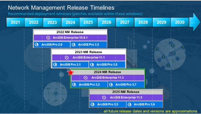

DamienPyne
Also, another consideration is your Pro/Ent pairing.  We have been advised to keep our products aligned as per the release plan:
Announcing the 2024 Network Management Release Plan (esri.com)
Pro3.1::Ent11.1
Pro3.3::Ent11.3

rlyding
Support was able to replicate the issue and it has been logged as a bug.
BUG-000167562 : In ArcGIS Pro, when attempting to set terminal connection the Error Message: More than one coincident devices found is displayed in the Modify Terminal Connections Pane.

In versions before ArcGIS Pro 3.3 the workaround I had was to make sure the UN line layer you where using to set terminal connections was above any other line layers in the content window.
In ArcGIS Pro 3.3 where the line layer(s) are in the contents pane doesn't matter anymore, but if you have the UN device layers multiple times in your map you get the above error. So 3.3 fixed one issue, but created a new one.
Here is the link to the bug in 3.3. https://support.esri.com/en-us/bug/in-arcgis-pro-when-attempting-to-set-a-terminal-connect-bug-00016...
Currently no support work arounds listed for 3.3. The workaround I have been using in 3.3 is to set the terminal connection from/to attributes via the attributes pane for existing features. For new features in Pro 3.3 you can now also use the new Snap Chip which allows you to select a terminal when snapping to a line. Or you could remove any duplicate device layers in your map which depending on how you have things classified might not be ideal.
If you are on Pro version 3.1.5 make sure the UN line layer you use to set terminals is at the top most level in your contents of your map and is selectable and editable. What I did in my edit map is pull in the UN line layer with no definition queries and made it the top most layer and I toggle it on and off as needed when I set my terminals. Further down in my map contents I have my other UN line layers classified out as need and those are used for all other editing except for when it comes to setting the terminals.
