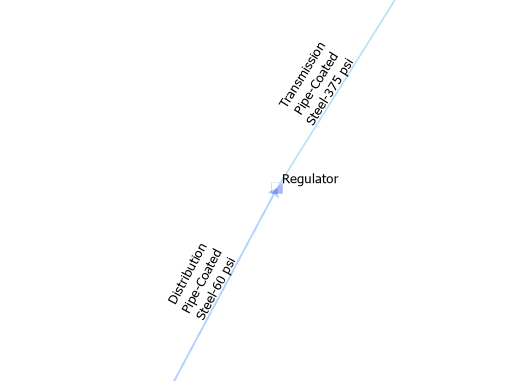

  1. When creating pressure subnet and setting up terminal connections on the lines that are on each side of regulator, which is subnet controller, is the digitized direction of lines important to control how subnet is built. Ideally, gas flow from transmission pipe to distribution pipe via regulator (high pressure to low pressure). But I have transmission line digitized away from distribution pipe, while Distribution pipe is digitized toward Transmission (see screenshot below). In that case, I was wondering if gas pressure subnet can be built correctly? Or should flip the lines to simulate real world situation?

1. Yes. There could be gas flow bidirectional on the pipe somewhere. But the question I had was more about the lines connecting to subnetwork controller via terminal, since the terminal configuration on the regulator (as subnet controller) is defined as directional, and gas flows from transmission to distribution and it is one-way flow. In this situation, if digitized direction of the line matters when building subnet.

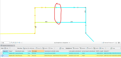

4. I am sorry I didn't explain my question well. I was looking at Naperville pipeline sample data from ESRI. Take below as example, my question was, what to make west Pressure Subnetline (yellow highlighted, 425 psi) stops at where it meets Aurora Pressure Subnetline (Cyan color 275 psi) although there is connection between two pipelines? If I run Update Subnetwork GP tool with my own data, the pressure subnetline would run through without stop. I must physically disconnect two lines from each other to make subnet line stop. But looking at Naperville data, there is no physical gap or anything at connection, but subnet line stops. That confused me.

1. Digitized direction does not impact subnetworks or the calculation of upstream/downstream. The only time the digitized direction of a line comes into play is when the "Use Digitized Direction" option is used to perform an upstream or downstream trace to use line direction instead of subnetwork. This option is not available for subnetworks.
4. Both pressure regulators are defined as subnetwork controllers for the 275 psi pressure zone (two controllers, one subnetwork), and the each of the lines are connected to the appropriate high pressure/low pressure terminals on the regulators. When the 275 psi pressure zone is traced, it knows to stop at those regulators. When the 425 psi pressure zone is traced, it sees that the regulators are regulating a pressure zone on their downstream terminals so it knows to stop.

Q4, It is Controllable Valve not regulator. There isn't a subnet work controller here.
CV's device status is closed, Tracing subnetwork would stop because it's a conditional barrier. But why the pressure subnet line created by updating subnetwork GP tool stops here...

Ooooh it's a controllable valve. I'm not sure I understand your question, but I'll try to answer anyways.
The subnetwork line is created using the line features that represent that subnetwork (typically mains in a gas network). In your example, the valve causes the subnetwork trace to stop on the southern run and the compressor on the northern run acts as I described above. Because the lines on the other side of that valve aren't part of that subnetwork they aren't included in the subnetwork line for 425. They are, however, included in the subnetwork line for 275 pressure zone.

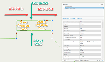

I am looking at how that subnet line is created at first place and why it stops. Subnet line was created by update subnet line geoprocessing tool and it doesn't look at conditional barrier but still stops..In my own data, the subnet line wouldn't stop at CV but continue on. I am trying to compare with Naperville data for any difference.
LiliYu2
ahh, I am sorry. There IS compressor (subnetwork controller) in the north area. That makes sense to have subnetwork line stops here.
So the subnet line in the south still stops at CV, what to make it stops?

Update subnetwork performs a subnetwork trace using the trace configuration included in the subnetwork definition for the tier of the subnetwork being updated. The subnetwork definition for pressure zones is that they have a condition barrier that stops at closed valves (among other things), so the subnetwork trace is performed using those condition barriers and the update subnetwork tool updates the subnetwork line and subnetwork name field to match the results of that trace.

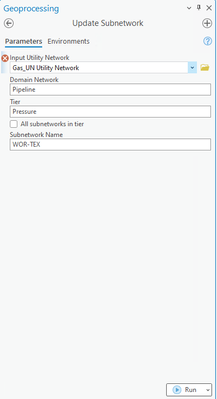

I thought update subnetwork GP tool would look at Conditional Barrier set in subnet definition. But in my data, it continues on a closed device without stopping, so I looked further why subnet line stops in Naperville at CV but mine doesn't, then I looked how update subnetwork geoprocessing tool works in detail, top is the tool interface, bottom is the tool parameters behind the scene and it appears that conditional barrier is not considered by default. If that's true, why pressure subnet line could stops at CV in Naperville. I am not talking about trace, I am looking at the result from Update Subnet tool, which is how subnet line created in Naperville, I am assuming Naperville uses this tool to create Pressure Subnet Line.
arcpy.un.UpdateSubnetwork(
in_utility_network="Gas_UN Utility Network",
domain_network="Pipeline",
tier="Pressure",
all_subnetworks_in_tier="SPECIFIC_SUBNETWORK",
subnetwork_name="WOR-TEX",
continue_on_failure="STOP_ON_FAILURE",
condition_barriers=None,
function_barriers=None,
include_barriers="INCLUDE_BARRIERS",
traversability_scope="BOTH_JUNCTIONS_AND_EDGES",
propagators=None
