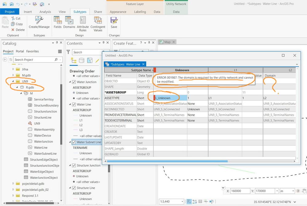

JamalNUMAN
Legendary Contributor
I’m encountered on the same issue while documents don’t offer that much of help. For example, I couldn’t manage what to do as I got same error (001987: The domain is required by utility network and cannot be modified)

JamalNUMAN
Has any one figure out how to resolve this issue?
The data is attached
