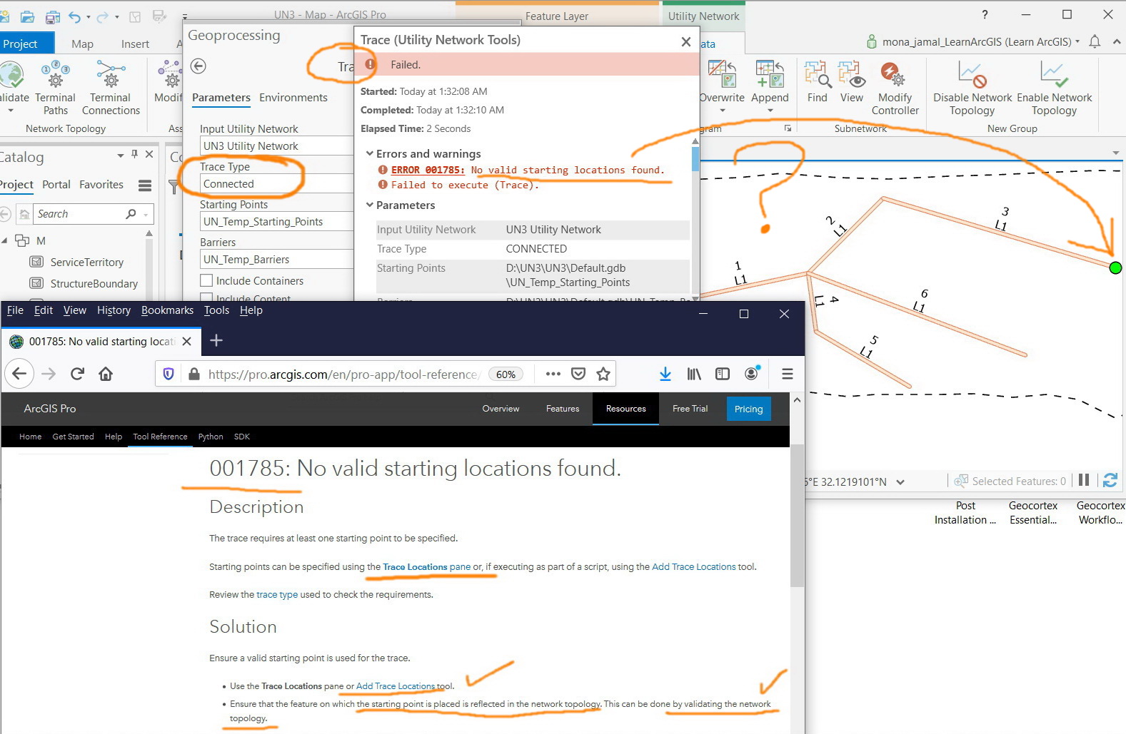

ArcGIS Pro 2.6: Connected tracing ends up with “No valid starting locations found”,
Despite the fact that a starting point is added correctly on an edge that participate in a utility network, the Connected tracing ends up with “No valid starting locations found”.
What could be the issue here?

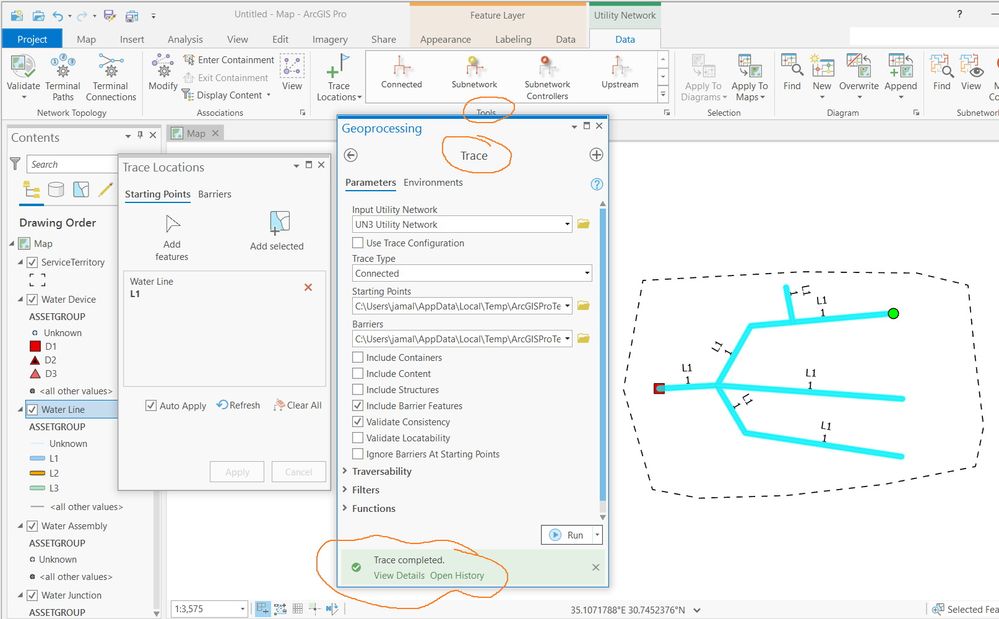

   I took a look at the data.  I was able to repo the issue.  Once I disabled Topo and Enabled it again, the trace worked.  So the data was not in the network index.  I am not sure how this happened.  What was the ordered of events?  Did you sketch in the data or did you append it?  Was the data sketched first and then the rules added?

Hi Mike,
Right. disabling\enabling the network topology resolves the issue despite the fact that the popped-up error has nothing to do with the solution
