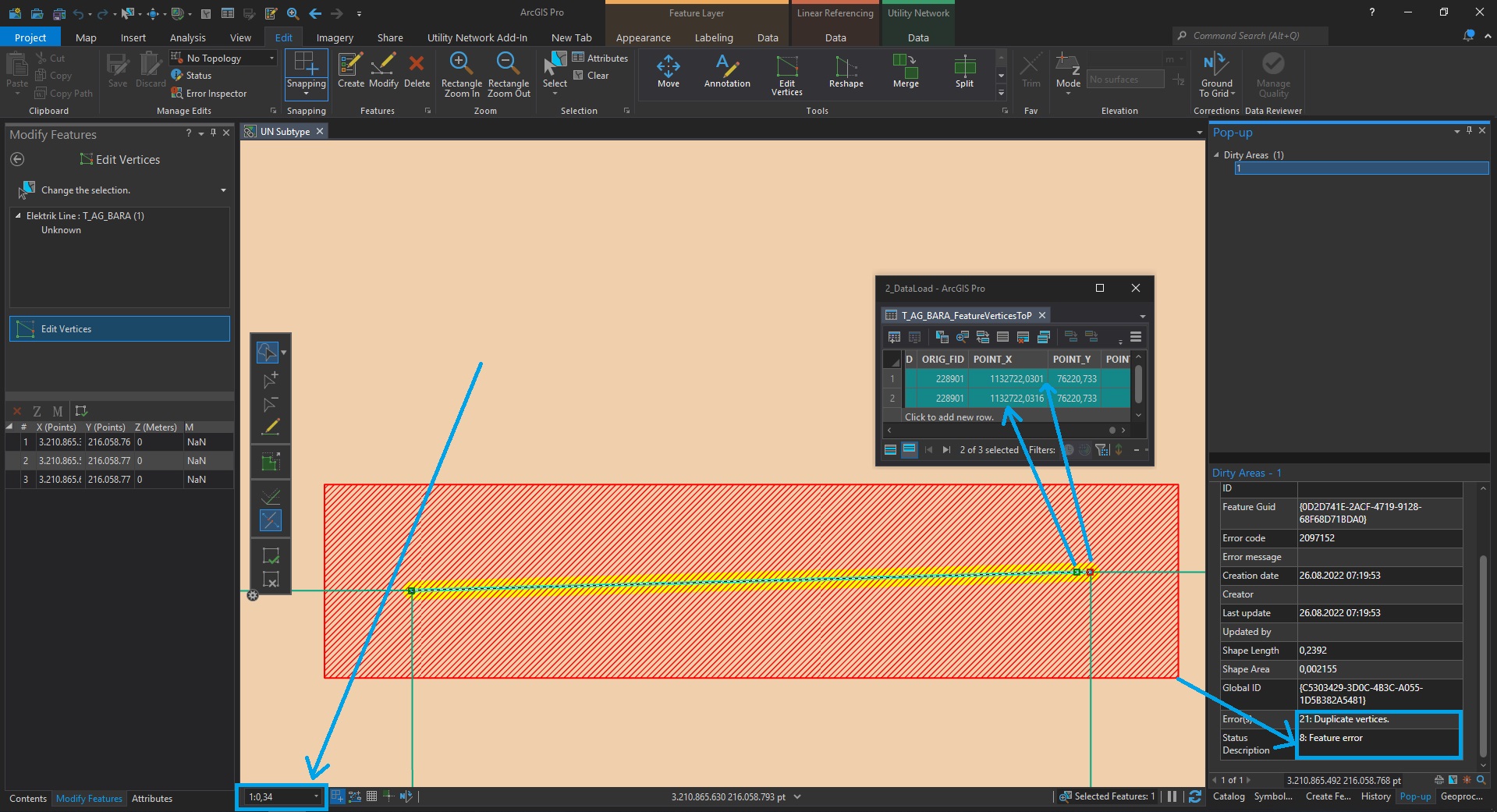

Hi,
As can be seen from the screenshot, I am getting a "duplicate vertices error" because of two vertexes that are very close to each other. They are not actually in the same coordinate, but it acts as if they are in the same coordinate because the precision is very low.
Is there a tolerance for sensitivity?
How can I avoid such situations? 

Check the Spatial Reference properties, including X, Y, Z tolerance and resolution.
