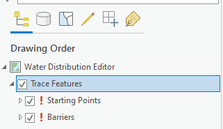

Hello, I struggle with understanding Utility Network. It might be possible that it is easier to teach a dog to ride a bicycle.
I am going through the Tasks provided in Water Distribution Utility Network Foundation, with Water Distribution Editor map. I would like to Locate Leak Location, but I don't get past Adding Trace Locations. The option to Apply added starting points is disabled. I haven't changed anything in the Project File. Network topology is enabled and validated, there are no Dirty areas. I am working on ArcGIS pro 2.9.

Hello Anete,
I have seen this before where the trace features path is broken:
Can you check for a valid path and if it is broken set the source to the default geodatabase here:
I hope that helps,
Joel

Ran into this exact issue today with the Water Distribution Utility Network Foundation template and going through the Leak Location Task.  Remapping the broken paths fixed the issue.
