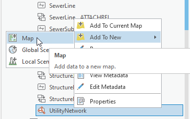

@TJ_Houle This issue is encountered if you right-click the feature dataset containing the utility network to add it to the map.
Sorry for the inconvenience, we have addressed this with the upcoming Pro 2.8 release.  The issue should not be encountered if you right-click the utility network itself and add this to a map.

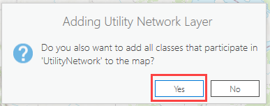

Try right-clicking the Utility Network in your File UN and add it to a map. It will ask you if you would like to add the rest of the classes. Click Yes. It should accomplish the same task you posted above.
Hope this solves your issue.
