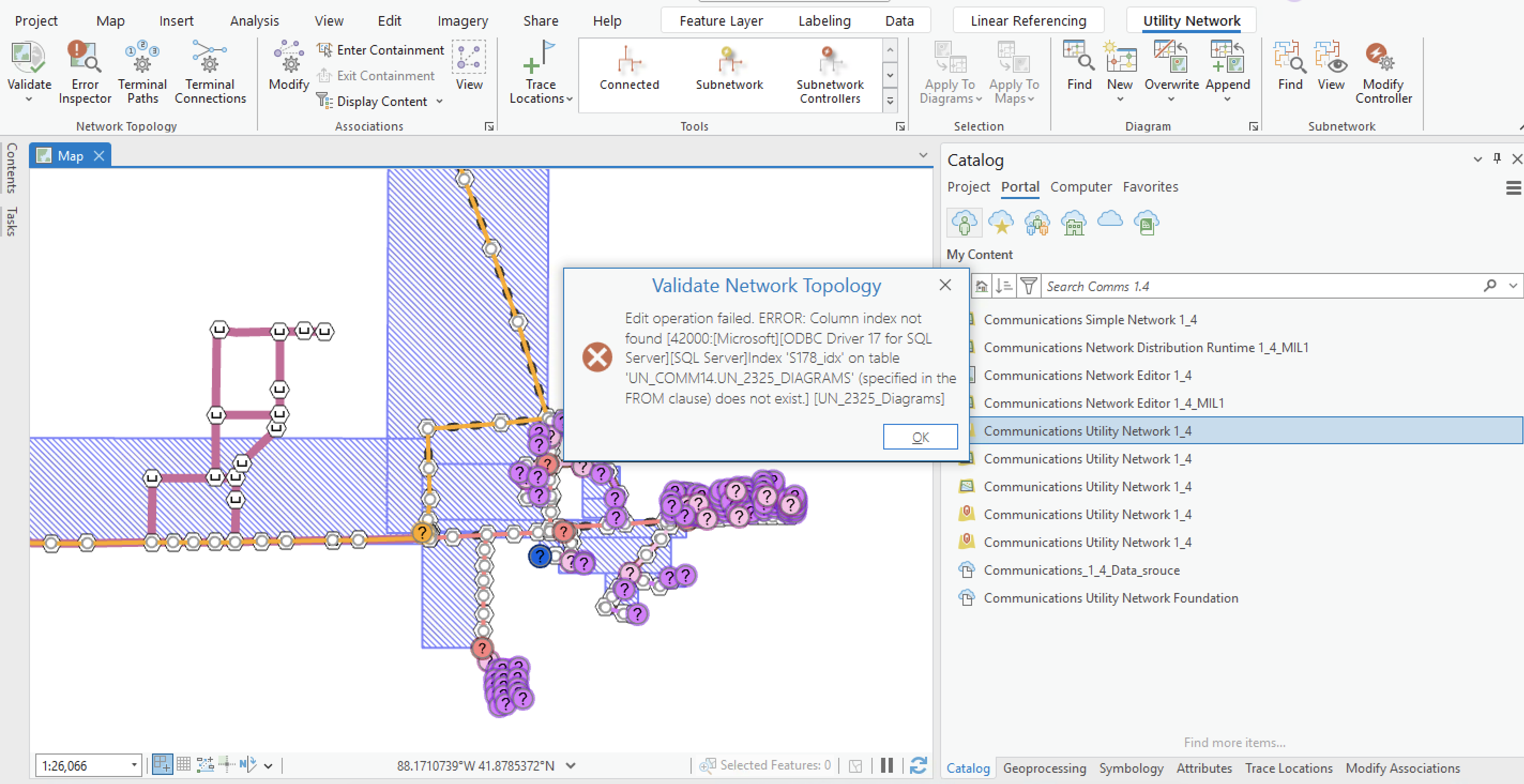

I'm trying to validate the network topology after an edit operation on the Communications Utility Network Foundation on an ArcGIS Enterprise. ArcGIS Pro complains about an index on the UN_2325_DIAGRAMS table:

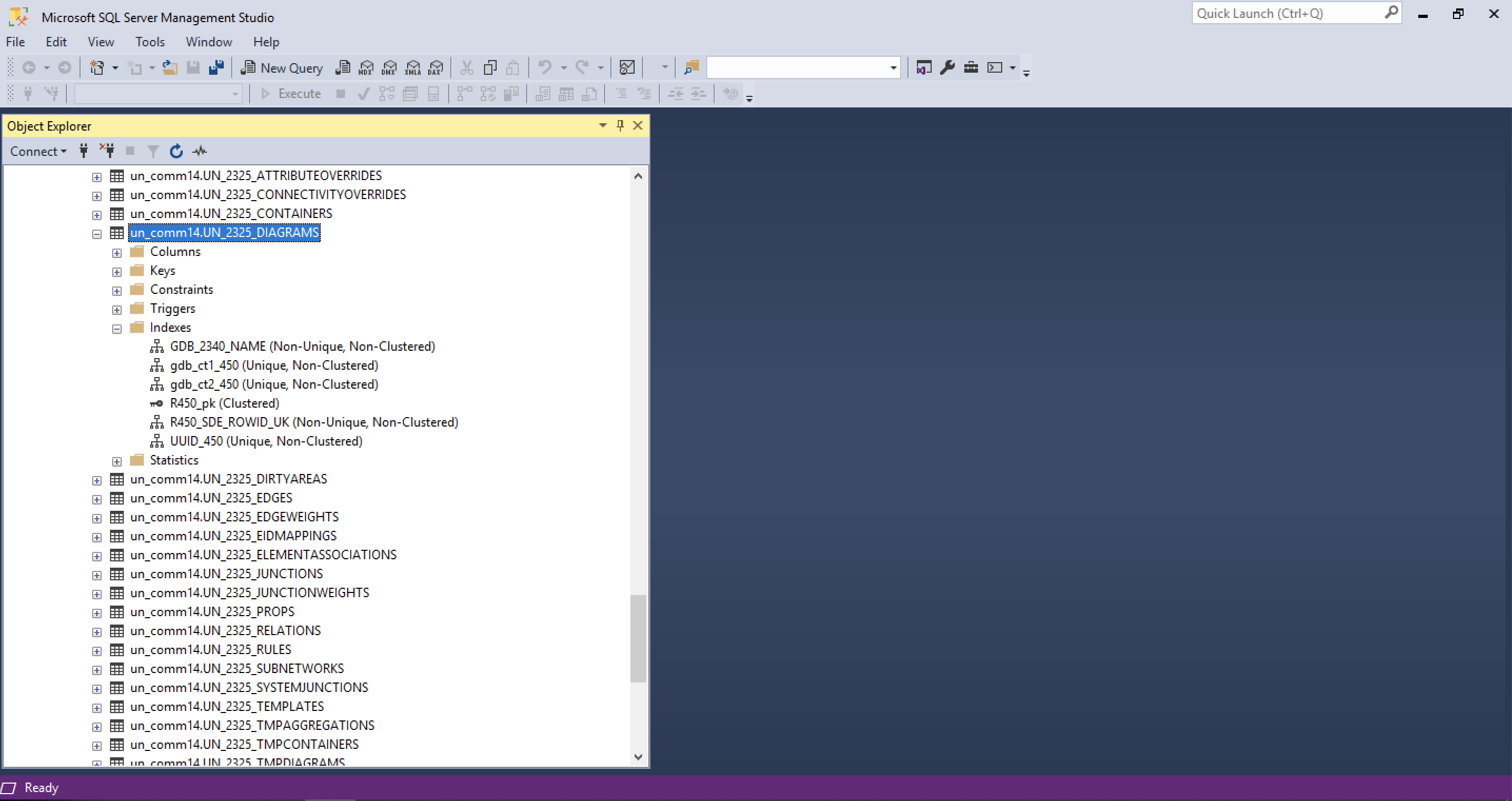

Investigating through the RDBMS management tool, it looks like the index mentioned in the error message (S178_idx) doesn't exist:
Now I can't validate the network topology and clean the dirty areas and even worse is that I can't roll back to the previous state (unfortunately the edit was not on a separate version), which would lead me to redeploy the UN.
Does anyone have any ideas/suggestions about what could be wrong with this environment and how to proceed with cleaning the dirty areas?

Thanks for the reply. I did check that for all of the UN "visible" feature classes (by visible I mean feature classes that are listed in the catalog). This specific table looks like something internal to UN, I think we don't have direct access through Pro to what's called "UN_2325_DIAGRAMS". Makes sense?

I added the index through arcpy and after that topology was validated without any errors. I was a little concerned about adding the index to a UN "system" table but it looks like everything is working normally again. Appreciate your usual help.
