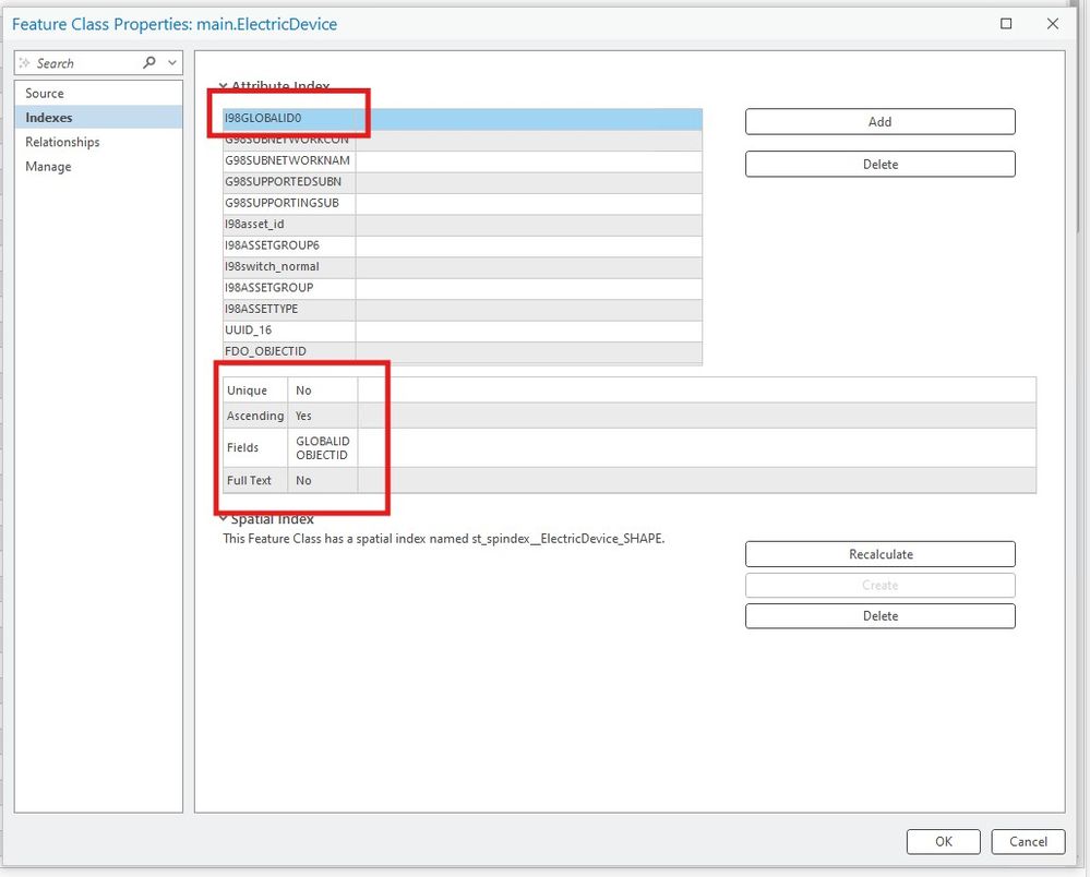

After creating a Utility Network in an enterprise geodatabase, I noticed that an index had been created on both globalId and objectID fields, and that this index was not unique.
non-unique index in SDEnon-unique index in SDE

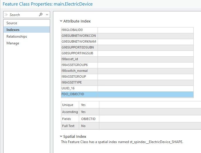

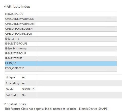

@PierreloupDucroix - I think the difference between the two examples is that the index in SDE is made up of two fields here - GlobalID and ObjectID whereas the one in the mgdb is just the GlobalID.
To get past you problem - adding an index with just the GlobalID field and setting it to unique should do the trick. I don't believe that will have any negative impacts on performance.
There are 3 index(indices?) on the mgdb that involve the GlobalID and ObjectID.
When set individually they are unique but not when used in combination.

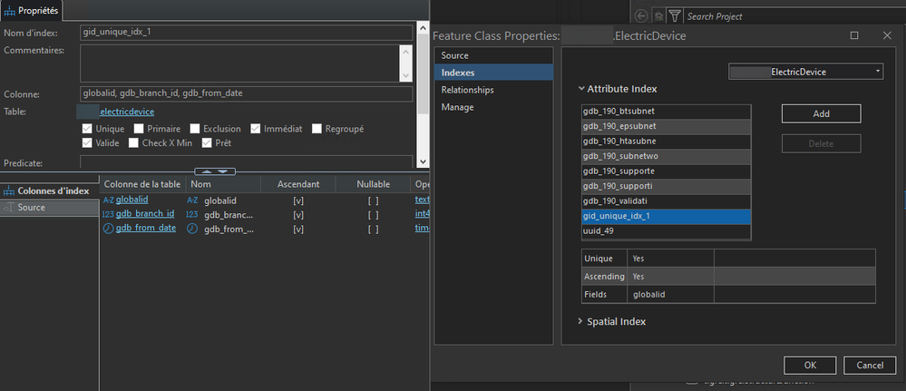

Well, initially, I had the same idea, but I thought adding a unique index would break the globalID mechanism and prevent me from modifying the objects. Indeed, any modification results in duplication of the row in the table (due to archiving), but as Robert correctly pointed out, the "add attribute index" toolbox overrides the index to include the gdb_from_date and gdb_branch_id fields.
Here's an example of what's in the database versus what I see in the UI :

@PierreloupDucroix I was not suggesting using the add index tool to create your own unique index on this field. I was showing how the OOTB field should look once the enterprise data is versioned.
