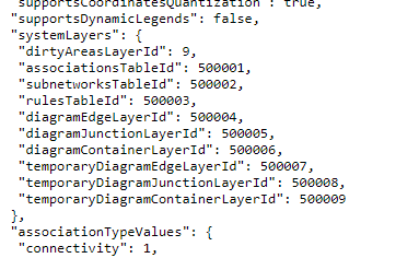

Associations - Through services, you will add associations via the association table and the apply edits capability.  You will insert rows just like they are features.  This table is hidden with you look at the rest page, but it is at layer id 500001.  To find all the UN hidden tables, you need to look at the json of the Utility Network layer in the feature service.
Controllers -  Same answer as associations, but 500001
