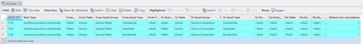

Below is a screengrab of my B_Rules table, noting that there are only distances nominated for meter to service connection, and not meter to meter. The rest of the table's distance values are <Null>:

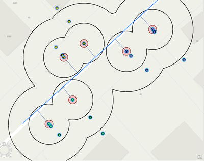

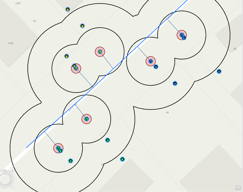

Below is a screengrab of my meters and service connections. Red circles are 1 m buffers around the service connections that I'm testing. Three meters are within a red circle and I expect them to have associations generated when I run the Create Association Records GP tool:

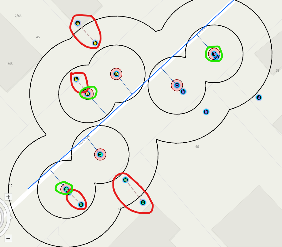

The tool runs successfully, but too many associations are generated. In addition to the three I expected (green circles), an additional four (red circles) were generated that connect meters with other meters:
One pattern I note is that meters that are not connected to anything are >5m away from the next device, otherwise this looks random.

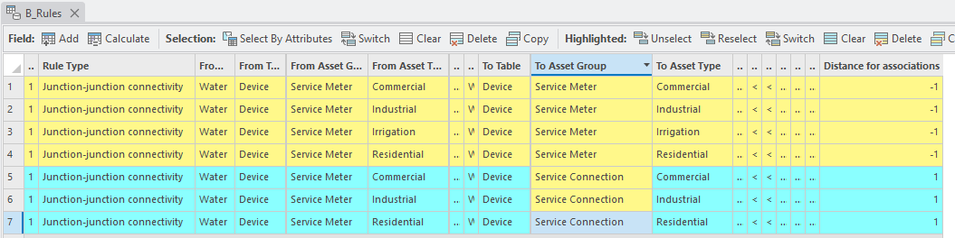

To prevent the association records from being generated I was able to put in a distance of -1 for all the undesirable meter-to-meter connectivity (highlighted rows below):

The embedded tool help has the following info, which matches what you are seeing:
To define distance, add/populate a double field in the B_Rules table, "association_distance". This value will be used as a search tolerance for features that match the rule.
If this field does not exist, or the values are null, then a default of 5 units will be used.
Rows with a negative association_distance will be excluded from processing.
I added an issue to get this added to the web help.

Thanks for the tip - I searched high and low for this info on the Esri pages and didn't think to hit the little "?" within the tool parameters box.
