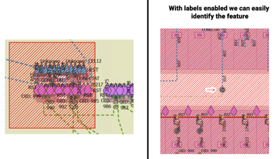

Hello,
I'm having a problem with the size of the dirty area polygons, especially the ones for the point features. The generated polygons are too big and overlap with the other dirty areas and it makes it very hard to identify the features causing the errors.
Here is an example:
It seems the size of the dirty area polygon equals the spatial reference's linear unit value (in our case it's 1 meter). Is it possible to change this default size?

BogdanHristozov
I think you are talking about the Summarize Utility Network Error tool. I've already used it and it helps a lot for  identifying the errors.
I was hoping if there is the possibility to set the size of the dirty area as well, because while we are editing the internal line schemas, the generated dirty area polygons are too big and overlap with all of the equipment inside.
It seems the only option is to extract the generated polygon features and to then modify their geometries.
Thank you!
BogdanHristozov
As a workaround - the labeling of the dirty area layer can be updated to show the ObjectId of the origin feature or to just point to the centroid of the polygon:
