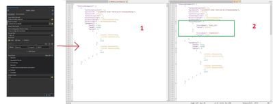

I generate json using the Features result type parameter, the json content in screenshot number 1 gives me this.
I want to get the fields I specified in the json results as in screenshot number 2.
How can I do that ?
thanks,
MikeMillerGIS
Esri Frequent Contributor
You need to generate a trace configuration that has that information.  The Add Trace Configuration tool currently does not expose that information, so you need to create a Trace with Feature Output and define the fields, and use the Trace to Trace Config tool to create the Trace Configuration as this uses Import Trace Configuration and will create a trace config with the feature field and network attribute information.

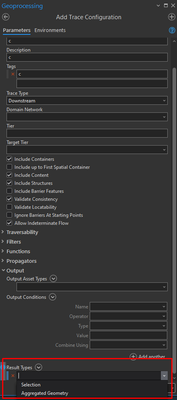

The add trace configuration tool only provides Selectin and Aggregated Geometry options. Does not allow field define
MikeMillerGIS
You cannot use Add Trace Configuration.  Use Trace and fill it out as you want.  Then use the Trace to Trace Configuration tool in the UtilityDataManagementSupport toolbox.  This uses the python syntax from trace and converts it to a Trace Configuration

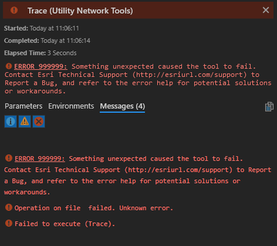

I created a trace with Feature Output and define the fields. Then I was able to create a Trace Configuration with the Trace to Trace Config tool. When I try to run this configuration, I get this error. The configuration contains field definitions and the directory path information where to extract the json file.
MikeMillerGIS
What version of pro/enterprise?  Do the server logs or the ArcGIS Performance monitor provide any more details?
