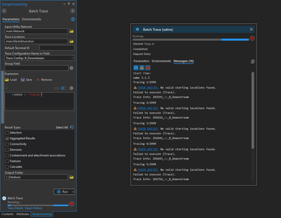

Hi all,
I have 150 Low Voltage Service points for which I have TracePoints1 printed in the General Notes area. At these points, I want to produce separate json by doing upstream traces for each of them. After throwing a flag at each of these starting points one by one, it will produce json, then the first flag will be cleared, it will move to the next point, throw a flag there and produce json. The process will repeat this way for 150 starting points. How can I do that?
I want to get the AssetID parameters of the circuit breakers by generating json from 150 starting points.
I want to make a process automation for these processes from the points I marked on the map. How can I do these things with Python?

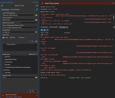

I reviewed the toolkit but I'm getting errors, is there a source showing how it works? 
MikeMillerGIS
Esri Frequent Contributor
Can you try the version here? https://github.com/Esri/Utility-Data-Management-Support-Tools/tree/Preview3.1.2
Make sure to remove the old toolbox(best to delete it) and restart pro.  If that does not work, I can pull the 3.1 code and look at a fix for that issue

I ran the updated version and I don't get any errors. But this time I see that you have bypassed many of my starting points. I get a "No valid starting locations found" notification. When I examined the data, I could not see any problems at the starting points.
I used the parameter (notes = 'Trace1') for the starting point. I want to trace 2999 points, but as a result I get 310 output.

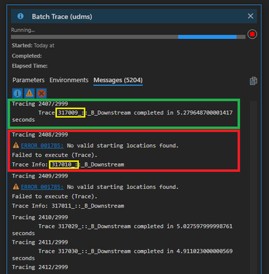

In the screenshot, starting points 317009 and 317010 are in the same tier. It gives error 317010, I do not get any errors when I trace on the map. There are many examples like this, why can't it find the starting point?
MikeMillerGIS
I am not sure then. I just ran through my junctions and they worked. If you manually set a trace point at that junction and use the same trace config in the gp trace, does it work?
JohnGoat
Yes, when I trace with the GP tool, I do not get an error at the same point. I don't understand this anyway
MikeMillerGIS
If you put a SQL query on batch trace for that one row, does it work? What if you put default terminal Id to 1?
Does your junction layer have a field called terminalid or featureglobalid?
If you pass in the starting point layer that you used to test the trace(in default database) to batch trace, does it work?
For tracing junctions, the required fields are featureglobalid(if does not exist, batch trace looks for globalid) and terminal Id.
