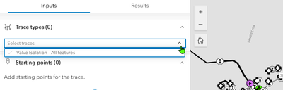

Hello @AlixVezina
Is there a way to assign a Named Trace Configuration to  the utility network Trace widget within experience builder portal v11.3? I have a simplistic app that uses a map with only a single names trace in it. Seems silly for the user to have to pick this one value...
AlixVezina
@ahargreaves_FW
Not in Experience Builder. But if you build an app using the Maps SDK for JavaScript, you can preset the trace type by defining the selectedTraces property.
