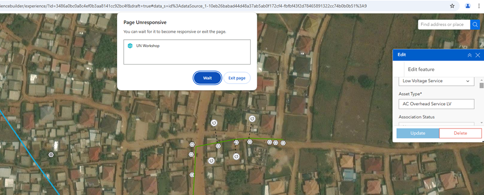

Kindly, I have a question regarding ArcGIS Web Editor for creating and editing for Utility Network feature services particularly for electric lines. Because i have been trying to create an electric line as low voltage service as asset group from low voltage service as an asset type of electric Junctions to single residential as asset type of electric device but it can’t be create and also the browser get stack immediately. It seems this editing for electric line is not supported. I wanted to hear your view or any guidelines would be very helpfully.
I also tried editing an attribute of a created low voltage service but still got same issue.
Here is an attached example.

@Davis_Dad23  - ArcGIS Web Editor is different platform https://www.esri.com/arcgis-blog/products/web-editor/announcements/arcgis-web-editor/
From what I can see in your screenshot, you are using the Edit widget with Experience Builder.
We use the Edit Widget for simple edits in Experience Builder shown in the video below.
(view in My Videos)
Things to note - The Edit widget doesn't allow for Network Validation / setting of subnetwork controllers out of the box. (unless you manage to hit REST endpoint via a customer widget)
ArcGIS web editor is a superior alternative to Edit Widget.
It's also available as standard in Enterprise 11.4 with the Creator user Type.
