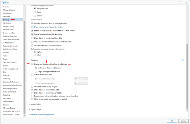

  • I suggest turning on edit mode toggle. This prevents Pro from always being in a edit session (See settings images below)

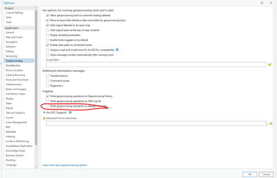

  • Disable GP tool metadata if you don't need it.

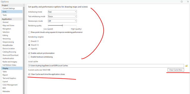

  • Turn on clear cache option on project close. When project is closed clears the cache.

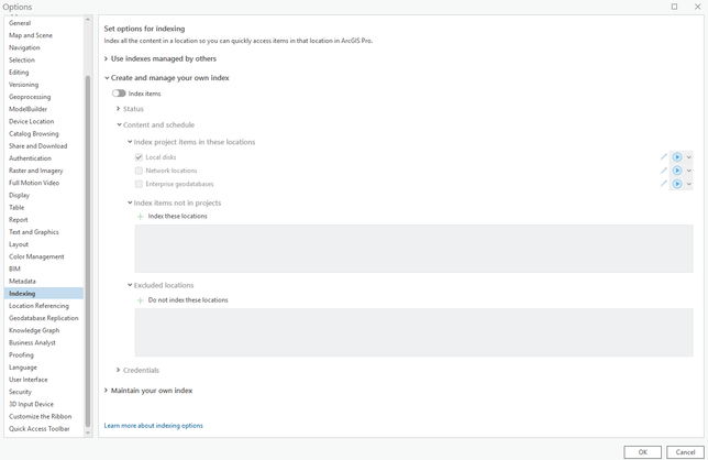

  • Disable Indexing in Pro settings if you don't need it.

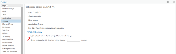

  • Disable Project Recovery in settings if not needed.

Enable Edit Mode toggle
Disable GP Tool Metadata
Enable Clear Feature Cache on Exit setting. I also normally use DirectX 12 and set rendering quality to half.
Disable Indexing
