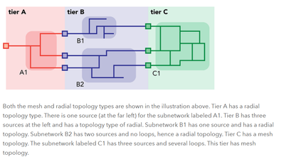

The documentation at https://pro.arcgis.com/en/pro-app/latest/help/data/utility-network/tiers.htm shows the differences with nice graphics. However, it mentions that
  • Partitioned—Supports systems that are sequential in nature, such as electrical and telecommunications utilities
  • Hierarchical—Allows you to model networks that are nested, such as gas and water networks
Does it mean that electric and telco networks have to choose Partitioned and gas/water have to choose Hierarchical?
The graphics for "partitioned" tier shows only "radial" network while graphics for "hierarchical" tier shows "mesh" network. But the same document says
  • Radial—Consists of one or more subnetwork controllers
  • Mesh—Consists of one or more subnetwork controllers
Note:
The topology type currently does not provide a difference in behavior for tracing or subnetwork management. The functionality is under development and will be applicable in a future release.
(Curiously, above note is present from day-1 of the UNM model documentation)
So, apart from hierarchical tier having multiple subnetwork name attributes and asset belonging to more than one tier at the same time, what is the difference?
