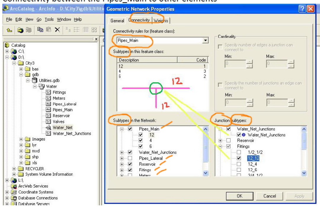

I couldn’t figure out if there is away to configure the connections between all the utility network feature classes as it used to be in ArcMap as shown in the screenshot below.
With the ArcMap approach, one is able to configure the connections between each feature class an all other feature classes participating in the utility network in one place

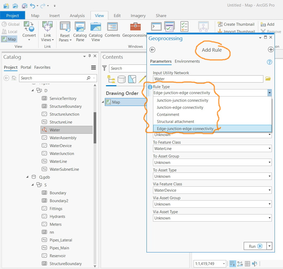

Hi Jamal;
The network rules have changed significantly from the geometric network to the utility network.  With the release of ArcGIS Pro 2.6, you may want to explore the trace network as an option for your network requirements.  The trace network has tools to enable you to convert geometric networks directly into trace network formats with more simple schemas and trace directions as a function of the direction of the line edit.  I would encourage you to watch Larry's trace network overview during our session during the virtual UC (below).  During the ArcGIS Pro 2.6 release the trace network also has flow arrows (as per your other Geonet post).
