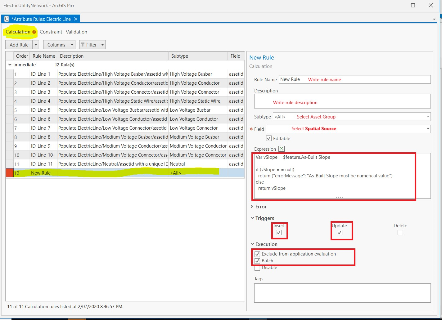

I need a arcade formula to auto populate an attribute in arc pro utility network for the attribute rules.
so this is kind of it
IF (As-Built Slope) is Not null. That is its filled in with any typed in numbers.
then (Spatial Source) = As-built.
Asbuilt Spatial Source is in a domain and its value is 1.
Thanks.

Hi Todd,
Please follow the steps shown in the below image.
Hope this will help you.
