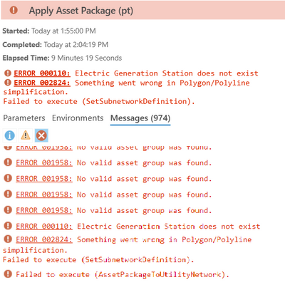

Dears I have an issue with Apply Asset Package script (tool) while working on Utility Network:
A.Messages
ArcGIS Pro 2.9.2.32739
untools 2.9.1
Executing from ArcGIS Pro, 2 map(s), activeMap = True
Parallel processing enabled: 6
Asset Package schema version: 2.4
B.Erros:
ERROR 000110: Electric Generation Station does not exist
ERROR 002824: Something went wrong in Polygon/Polyline simplification.
Failed to execute (SetSubnetworkDefinition).
ERROR 001958: No valid asset group was found.
WARNING 000952: Failed to execute (AssignDomainToField).El_Saket_1-1648037295443.png

I am not sure what is going on here.  Something is not being applied correctly.  Did you start with a new postgres gdb or was this an existing GDB?  I see you have maps open, we have seen where these create locks on the Utility Network and cause corruption.  Can you close all the maps, restart pro and apply the asset package to a new Postgres database?
