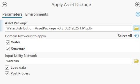

I am trying to Apply asset package and I keep getting this error. Have tried multiple times now. Any insights on this would be much appreciated.

What are your parameters?  What is your target GDB type?  Have you tried Asset Package to Geodatabase?

I am doing this process in a FIle GDB , created a UN in file GDB and using Apply asset package to this UN.
I am always getting this Domain Network error.
Is there a way to check the difference in the domains of my asset package and UN, so that I can find out what the issue is and fix it ?

Mike's recommendation to run AP2GDB before going through the whole Apply to EGDB is the way to go. We have it as part of our standard process. You catch a lot of stuff running AP2GDB without "polluting" the E-GDB. And then you easily clean up the AP and try again.
This minimal overhead saves a lot of time and headaches. Thank you, Mike,.

Try Asset Package to Geodatabase, it creates a new geodatabase, stages the UN and then applies the asset package.  This will eliminate some variables.
