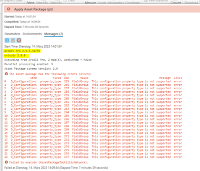

I also added D_CONFIGURATION and D_RENAME tables and ran Apply Asset package. However, I get the following error:
Is there some problems in table or do I need further steps for exporting asset package?
