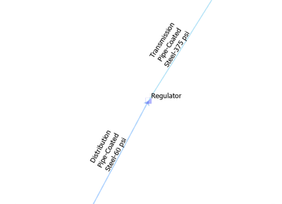

  1. When creating pressure subnet and setting up terminal connections on the lines that are on each side of regulator, which is subnet controller, is the digitized direction of lines important to control how subnet is built. Ideally, gas flow from transmission pipe to distribution pipe via regulator (high pressure to low pressure). But I have transmission line digitized away from distribution pipe, while Distribution pipe is digitized toward Transmission (see screenshot below). In that case, I was wondering if gas pressure subnet can be built correctly? Or should flip the lines to simulate real world situation?
