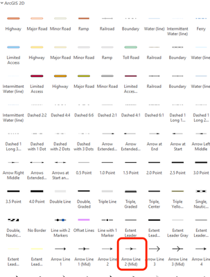

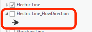

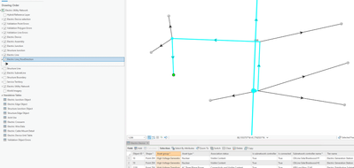

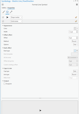

utilitier
Hi @JamalNUMAN
I have a suggestion for you, if it does it works.
The electric line, copy and paste it and rename as the flow direction.
And change the single syblogy line as ArrowLine2.
than remove solid stroke.
You are able to see the direction of the line (if you are using the UN, your drawing direction must correct in terms of the flow direction ). When you need to see the direction, turn on/of the layer.
