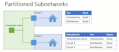

Partitioned
When the network topology is validated in a partitioned network, the system needs to identify the subnetwork affected by each edit. To do this it identifies all the tiers in the network that have subnetworks and analyzes each tier to determine which subnetworks in each tier, if any, were affected by the edit. The system repeats this process with each tier until it has discovered network sources for all the edited features, or all the tiers in the network have been analyzed. Let’s look at a few examples of this behavior in action.
In the first example below, a single edit is made to the utility network (purple hash polygon). When validate network topology runs it finds a single network source for the edit on the first tier it analyzed, the distribution tier. This allows validate to skip doing any analysis on the transmission tier since the system has already discovered a subnetwork controller that accounts for all the edits.

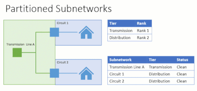

In the third example, the system validates an edit made to a feature that is not connected to any subnetworks. In this case, the system must trace all the tiers in the network to confirm that no subnetworks were affected.

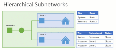

Below you can see an example of a simple hierarchical network that has a single system subnetwork that contains two smaller subnetworks.
In this first example below, a feature belonging to one of the smaller subnetworks is edited. The system first identifies the smaller subnetwork that the edit belongs to. However, because this is a hierarchical subnetwork the system must analyze all the remaining tiers in the network, and in this case, it identifies a second subnetwork in a different tier to mark as dirty.

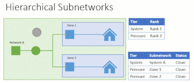

In the third example, a feature that does not belong to a subnetwork is edited. In this case, no subnetworks are marked as dirty. However, the utility network must trace each tier of the network to confirm that the feature doesn’t belong to any subnetworks.
