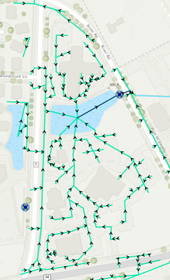

Let’s start by looking at an area of a stormwater network that has a series of conduits or pipes (light green lines) connected to several detention basins (blue polygons) that discharge at an outfall (point symbol) into a nearby river (blue lines). You can see this image below:
When lines are drawn to represent the flow direction of fluids from a high point to a low point in the system, flow direction can be visualized using the digitized direction of the line.When lines are drawn to represent the flow direction of fluids from a high point to a low point in the system, flow direction can be visualized using the digitized direction of the line.

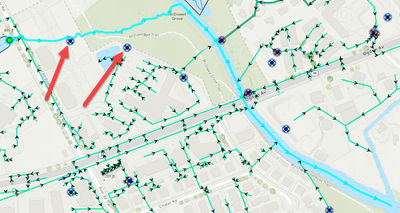

Notice how each line in our network has arrows on it? That is because the lines are symbolized using their digitized direction. This is important because each of these lines has been drawn from its high point to low point, or from high pressure to low pressure, allowing the digitized direction of the line to represent the flow direction in the network. Calculating the actual flow (volume and direction) of fluids in a network using gravity, pressure, etc. is the domain of an engineer using an engineering analysis tool. However, by maintaining the flow as the digitized direction of the line in the GIS you can use this to control the analysis of the utility network.

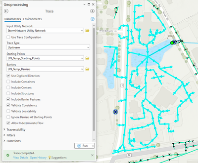

You can identify the areas that provide fluids that will discharge into the river by running an upstream trace from the outfall using the trace tool. Because the digitized direction of the lines in this dataset accurately reflects the flow of materials in the network, you check the Use Digitized Direction parameter. In the example below, the analysis starts at the outfall, shown with a green circle.
The utility network includes the ability to trace using the digitized direction of lines.The utility network includes the ability to trace using the digitized direction of lines.
If you’re curious to learn more, you can read this article published about how digitized direction tracing works.
Now that you can see which features discharge into the river, the next question is to identify the final discharge point in the dataset. This can be answered using the same starting point and a downstream trace using the digitized direction of the line. In the example below we are analyzing the same outfall from the same location, shown with a green circle.
By performing a downstream trace from an outfall (green circle) we can visualize the infrastructure downstream of this location.By performing a downstream trace from an outfall (green circle) we can visualize the infrastructure downstream of this location.
If we look closely at the downstream trace results, we can see several outfalls in this area that aren’t connected to the network, indicate with red arrows. These are important structures that need to be regularly inspected and may even have discharge permits associated with them. Running this trace allows this problem to be easily identified so that field verification of their locations and elevation can be gathered. This will ensure you have a complete, have a high accuracy model that can be used to support engineering and operations.

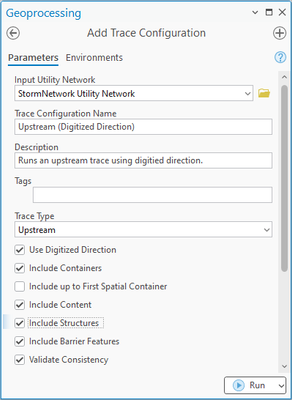

If you have a trace you use often in your utility network, you should consider creating a named trace configuration for it. Name trace configurations allow you to run a trace using the Trace pane without the need to select all the parameters in the tool every time you want to run the trace. Tracing in the web and mobile environment also benefits from the creation and sharing of named trace configurations.
In the case of gravity networks, you will likely want to create a named trace configuration for the upstream and downstream traces using digitized direction, for the reasons we discussed above. To do this, open the utility network’s Add Trace Configuration tool, give the trace configuration a name, then configure the trace you want to run. Below you can see the downstream trace we configured above.
Creating trace configurations makes it easy to share traces with web and mobile users.Creating trace configurations makes it easy to share traces with web and mobile users.
Note: If you want to include structures, containers, or non-spatial content in your trace results be sure to check those options. We include an example of why you may want to do this in the Containment example below.
After creating named trace configurations, they will appear in the Named Configurations tab of the Trace pane (see graphic below). To use them, add a start location for a trace using the Start tab on the Trace pane, select the named configuration you want to use on the Named Configurations tab, then click Run.
Desktop users can access trace configurations using the Named Configurations tab on the Trace pane.Desktop users can access trace configurations using the Named Configurations tab on the Trace pane.

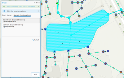

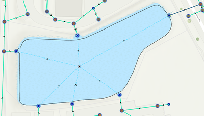

In our stormwater network there are many detention basins, that are used as a best management practice area for improving the capacity of the system during a wet weather event. There are pipes that drain into these areas, and outlets or overflows that allow them to spill over into the rest of the network once they’ve reached capacity. Below is an example of a detention basin with five pipes that discharge into the basin and one overflow that allows it to discharge into a nearby manhole.
A detention basin is commonly modeled as a structure boundary. This allows us to visualize the extents of the basins and infer its inlets and outlets.A detention basin is commonly modeled as a structure boundary. This allows us to visualize the extents of the basins and infer its inlets and outlets.
When you run a trace that passes through this basin, the basin itself is not selected. This is because the basin is not associated with any of the features in the network. If you want to associate a basin structure with other network features, you must determine the role of the structure in the structure network, then you must add rules that determine which features the basin is allowed to be associated to.

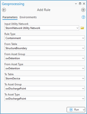

In the case of the basin, because it is a structure boundary it is already configured as a container. This means it can contain other features. You want it to contain the discharge points that discharge into it or drain water out of it, so the first step is to add a rule that allows it to contain those features.
Adding a rule allows us to model an explicit association between the detention basin and the discharge points that represent its inlets and outlets.Adding a rule allows us to model an explicit association between the detention basin and the discharge points that represent its inlets and outlets.
Once you’ve added the rule, you can then use the Modify Associations pane to add the discharge points as content of the basin.
Creating containment associations between discharge points and the detention basin allows us to identify the inlets/outlets for the basin through analysis. This allows us to unambiguously represent this relationship even if an outlet isn't contained within the detention basin polygon.Creating containment associations between discharge points and the detention basin allows us to identify the inlets/outlets for the basin through analysis. This allows us to unambiguously represent this relationship even if an outlet isn't contained within the detention basin polygon.
Note: The box next to each feature in the Visible column is checked. This allows it to be visible which enables you to see the discharge points on the map even when you aren’t explicitly viewing the contents of the container.
After running the trace, you can see that a downstream trace that passes through the basin will now select the basin as well.
Creating a containment association also means we can include the detention basin in our trace results. You can control whether to include structures, contains, and content in traces in your trace configuration.Creating a containment association also means we can include the detention basin in our trace results. You can control whether to include structures, contains, and content in traces in your trace configuration.

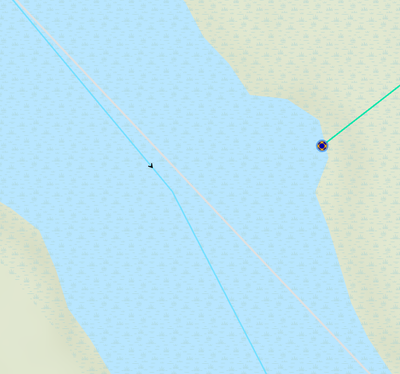

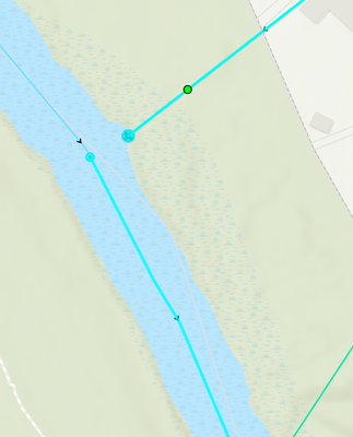

Maintaining spatially accurate outfalls and open channels in your GIS can create technical challenges where outfalls don't physically connect with the centerlines of open channels such as canals or rivers, despite discharging into these waterways in the real world.
Outfalls and canals are often not spatially coincident in a utility network because the canal line represents the centerline of the channel while the outfall is typically located on the edge of the canal which may be dozens of feet away.Outfalls and canals are often not spatially coincident in a utility network because the canal line represents the centerline of the channel while the outfall is typically located on the edge of the canal which may be dozens of feet away.
While some customers choose to address this by creating an artificial pipe or channel that connects the outfall to the channel, a utility network can be configured to allow features that are not spatially coincident to be connected through the creation of a junction-junction connectivity association between them. In this instance you would place a junction on the channel where we want the outfall to connect, then create a connectivity association between that point and the outfall.

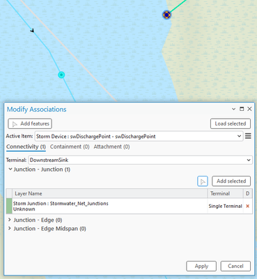

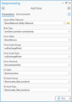

Before we do this, add a connectivity rule must be added to the network that allows these two features to be connected using this type of association. To do that you must first disable the network topology, a common requirement for making most changes to the utility network’s rules.
You then add a rule allowing for a junction-junction association between the outfall device and the preferred channel junction. In your data model the outfalls are in a Discharge Point layer and the junction you are using is a Stormwater Network Junction.
Adding a juction-junction connectivity rule allows us to connect junctions or devices that are not spatially coincident.Adding a juction-junction connectivity rule allows us to connect junctions or devices that are not spatially coincident.
One interesting option on the Add Rule tool is that you need to specify which terminal on the discharge point is allowed to connect to the network junction. Devices in a utility network can be configured to use terminals to manage connections. When a device has terminals every connection to that device must specify which terminal it is connected to. In the case of this outfall, because it is a subnetwork controller you need to specify which features are connected to the upstream or downstream side of the outfall. This information must be manually populated because the utility network does not use elevation for its analysis, and in certain scenarios features with a higher elevation (like an overflow) will be on the downstream side of a device. Setting the upstream/downstream features properly is critical to ensuring correct results for upstream and downstream traces.
Once you’ve added the junction-junction connectivity rule defined above, re-enable the network topology. Going back to the original location you will need to create a junction feature on the river to act as the location where the outfall will connect to the river channel to act serve as the location where the outfall will connect. Next, you can connect the outfall to the junction feature using the modify association tool, making sure to select the outfall’s downstream terminal.
Creating a junction-junction connectivity association between two devices or junctions allows them to be connected even though they are not spatially coincident.Creating a junction-junction connectivity association between two devices or junctions allows them to be connected even though they are not spatially coincident.

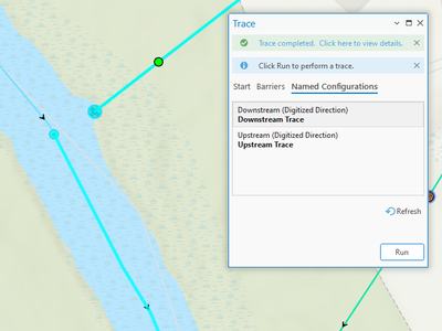

After validating the edit you can see that a downstream trace from the area upstream of the outfall will pass through the outfall, continue through the channel, and continue to make its way downstream through the system.
The utility network considers both the spatial coincidence (implicit connectivity) and associations (explicit connectivity) when performing analysis.The utility network considers both the spatial coincidence (implicit connectivity) and associations (explicit connectivity) when performing analysis.
If you want to see all the associations within your current extent you can click the View Associations button on the Associations group on the Utility Network tab. This displays dashed lines that represent all the connectivity and attachment associations within the current extent.
The View Associations command allows you to quickly visualize associations, like junction-junction connectivity, on your map even though the associations themselves have no geometry.The View Associations command allows you to quickly visualize associations, like junction-junction connectivity, on your map even though the associations themselves have no geometry.
