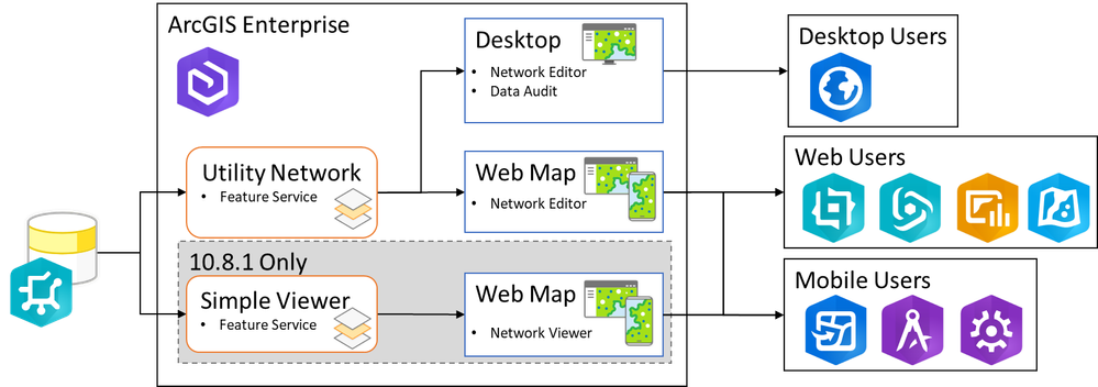

Using a single feature service with multiple maps is a more scalable solution.  This is the recommended approach for handling multiple displays, since publishing multiple services to handle different displays will consume unnecessary server resources.

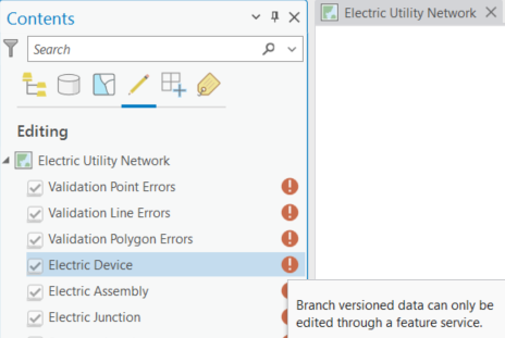

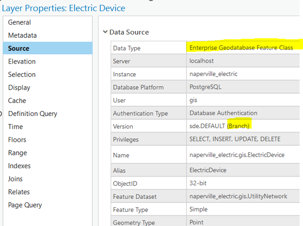

The utility network can only be edited using feature service. If your map contains layers/tables with database connections, you will not be able to edit the data. This is because the utility network requires branch versioning, and data that is registered as branch versioned is only editable via feature services.
Table of contents  --> select by editing --> you will see these errors when trying to edit through a database connection.
To edit a utility network, you must publish a feature service containing all the layers of the utility network and enable the Version Management capability on the service. You can learn about additional conditions and restrictions for publishing branch versioned data by reading the Share branch versioned data topic on the online help.

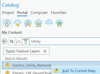

Using ArcGIS Pro, you can add all the layers/tables in a service to a map by right clicking on the Utility Network Item in Portal and then clicking on the “Add to current map” option.
This method will add the layers to your map using the default layer properties, including symbology, scale ranges, and label settings from the feature service. These settings can be modified in the map without affecting the underlying feature service.

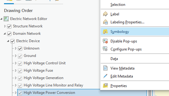

When building maps for the utility network, the preferred approach is to use Subtype group layers.  Subtype group layers are composite feature layers that contain multiple sublayers called subtype layers. Each subtype layer corresponds to one subtype in the Utility Network feature service. This way, each sublayer can be configured independently.
Configuring each subtype separately is often an important aspect of the utility network, as each subtype (also known as asset groups) typically has its own unique requirements for scale suppression, labeling, and symbology. You can learn more about why this is and try this out for yourself by taking the Configure a map for ArcGIS Utility Network tutorial on learn.arcgis.com.

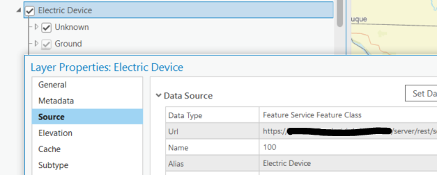

In the layer properties, notice how the subtype group layers’ underlying data type is from a feature service.
Sublayer properties, including symbology, scale ranges, label settings, and field properties can be modified independently. Each layer can be configured to meet your needs.

When standing up a new Utility Network project, it is often a good idea to split the foundation package into 2 distinct ArcGIS Pro projects. This allows you to separate out the maps used by administrators from the maps used by the end users.
The Administration project is used to manage the Enterprise Geodatabase (manage fields, coded value domains, subnetwork definitions, etc) and publish the Utility Network service. This project will contain maps with database connections.
The Editing project is used to configure the maps used during editing/auditing/viewing workflows.  Since you can only edit data through web services, make sure that the projects provided to the end users contain maps that reference feature services.
The target audience for these two Pro Projects are very distinct. The Administration project is targeted for the GIS admins / IT members whereas the Editing project is targeted to the staff who will maintain the utility assets. Only items (specific maps, toolboxes, folders, etc.) needed to complete the task should be included in these projects.
Distinct projects can be shared individually to the ArcGIS Enterprise Portal and groups can be used to ensure the right audience has access to them.
