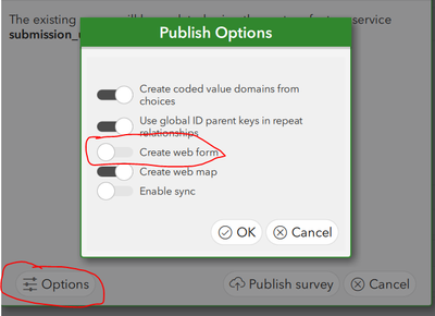

First just making sure you have webform turned on when publishing

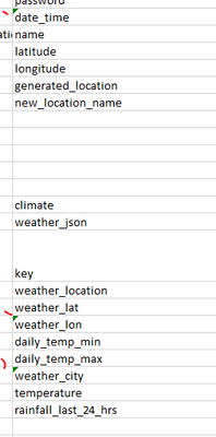

Second you have some fields that it is mad at.  I am not really sure why as they are close to reserved but are not.  When I try to change them it will not let me and gives an error.  Not sure how they got in there, maybe a copy paste.  I would try and get these fixed though to remove the green.  You also have fields ending in _ which is prob not a great idea.  Also list and group names ends with a _

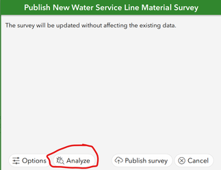

I too was greeted with this message today, 5-5-2023, (This survey cannot be accessed in the web app. Please contact the survey owner to republish the survey with 'Create web form' enabled. Error: Missing .webform file.after republishing a Survey123 Connect survey following some changes.  The survey had been working as expected prior to today's changes.  I reviewed several posts, checked my settings (e.g., Doug's 7-21-2022 post), and all seemed in order.  I finally remembered to run the Analyze tool in the Publishing window of Connect.
The action revealed a Critical error.  In reviewing the error in the Excel file that is created when running the tool, I saw I had a 'null' value in the 'bind::type' column for a 'Note' type field.  This null was in the wrong column, and not needed, so I deleted it.  I republished the survey.  I could then submit a record with no webform publishing error.
I have found the new Analyze tool useful on more than one occasion, but I tend to forget it is available.
