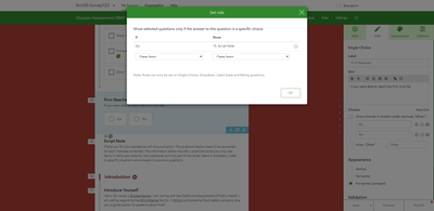

Maybe there's another issue? I would really rather not have to remake the whole thing. Here's a screenshot of the form with  one of the rules I'm trying to set (none of them will set anywhere in the form). In this case, I want the Note to only show if the person selects "Go" and not show if they select "No".
Thank you in advance for any help on this.
