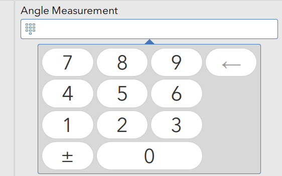

Numbers appearance has no Enter/Return key
This means you have to tap somewhere on the form to commit it, then tap on the next field to get it to bring up the next numbers.  I know this was causing an issue with data not saved as well.  If you could just hit enter and it goes to the next field (like non numbers does) that would save the user a tap – so twice as fast.  This seems to work on text fields now so maybe it was just missed.

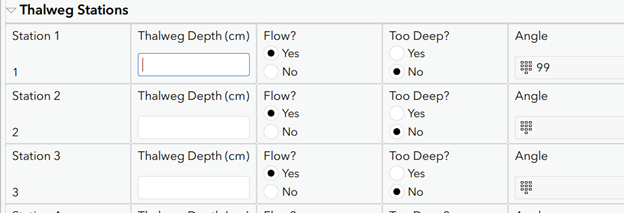

Ability to set Tab Order
I know this one as been asked for before but it is really slowing us down.  Every other forms program tested has this.  Just adding a column for tab order would work great.
Example
User adds a number to the first Thalweg Depth then hits enter.  It goes to Flow so the keyboard goes away.  Then they have to tap inside of Thalweg Depth 2 to get the keyboard back up, then add the number.  I would like to set the tab order to go straight down the Depth column – and make sure the keyboard stays up.  This is adding 2 taps and we do 100 to 300 of these per form on just this one part.

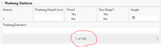

Keep keyboard up across repeats
When advancing a repeat the keyboard goes away.  This means the crew has to type, enter, advance repeat, tap field to get keyboard back, then enter again.  When doing 100-300 repeats this really slows us down.  Growing a repeat downwards would also work (and has been asked for a lot).  We often have one person calling out numbers as they walk a line while another enters the data.  The person on the tablet cannot keep up at all.

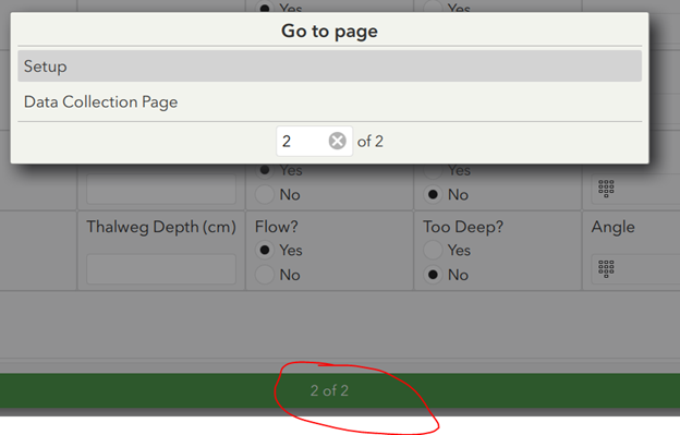

Ability to move between repeats like you can for pages.
For pages I can tap and go right to any page I want.  This is sweet.
But I cannot do this for a repeat.  That means on large repeats the crew must tap hundreds of times to review data.
I would like to just tap here and pick the repeat.
Tied into this is repeat indexing where I can ask which repeat I am on.  Also being able to have a repeat move to a specific entry would be sweet.  BTW naming the repeat bar or adding a color coding is asked for a lot - when nesting repeats it can be really hard to tell which is which.
