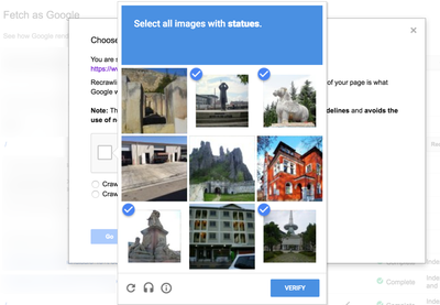

ahargreaves_FW
@JodyZhengLiu  thank you, and the Survey123 team, for the rapid feedback and considering this important need.
Our preference is Image recognition CAPTCHA (see screenshot). Further, some consideration of the use of geo IP would be beneficial also.
