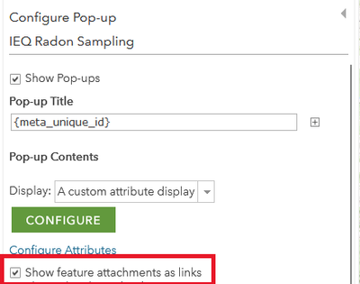

Photo questions dont appear in the main table (your screen cap). But if you select a record, you can see them in the side window (also in your screen cap). That is normal behaviour.
Where you are just looking to use photos in web maps, you can ignore the S123 Website (also your screen cap). Just go to whatever app you are using to build the webmap and/or popup (e.g., your Portal) and ensure that attachments are enabled.
E.g.,
Here is a blog post with a little info:
Rolling Out Related Records in Map Viewer (directly related to S123, as referenced here)
Pop-ups: tips for adding photos and images
