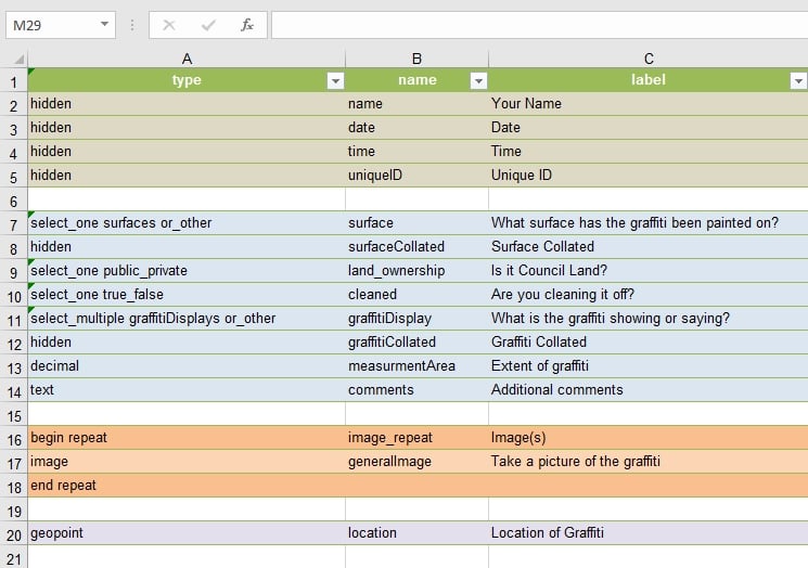

Hey, I have a survey123 form which has a repeat table so the user can take many photos if they wish.
I am now trying to make a map in AGOL with pop-ups that include the attachments, and I have no idea how to do this as the images are in a related table, not in the original feature table. I have attached the form I am using.
So I would love to see a map that includes a pop up with at a minimum the first photo taken with each form.

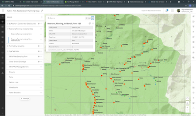

Hi James,
Is there still no way to show attachments from a related table in a popup with the new map viewer (formerly beta), maybe using Arcade? Also, in the classic web viewer, I was able to view the attachment links with a related table link in the popup,  and by showing the tables, but I do not see that option in the new map viewer, am I missing something, see screenshot below? Do I need to do something with Arcade expressions to display the attachment links? Thank you.

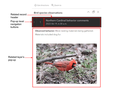

EmilyGeo
Hi all,
With the November 2022 update, Map Viewer rolled out support for viewing related records in pop-ups.
To get started,
  • Configure the pop up for the parent layer
  •     In the Add Content menu, choose Related records
  • Configure the pop up for the related layer/ table
  •        In the Add Content menu, choose Attachments
This configuration will allow you to navigate through the related records and view their attachments using pop-ups.
For more in depth information and examples, check out the blog article Rolling Out Related Records in Map Viewer.
