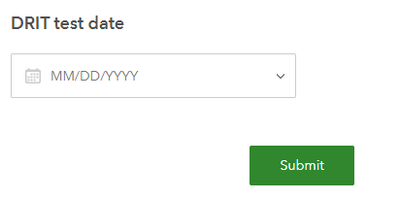

  • If a user does not select a date for date_drit_test, user does not see any choices for drit_test_result; the code "NT" will be entered into the database with associated label "Not Tested" when user presses submit:

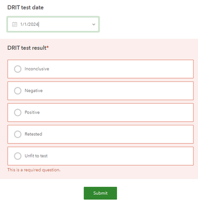

  • If a user does select a date for date_drit_test, they will be provided with the list of appropriate choices.
  • The only disadvantage of this solution is that as soon as a user selects a date, the next question drit_test_result is highlighted in red and tells them the question is required. I would prefer they get that warning at the bottom of the form or after they try to press submit, but I couldn't figure out how to delay the required message. I'm all ears if anyone has ideas!

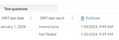

Here is the database as shown from Survey123 Data tab - note labels appear, not codes.

If a user does not enter a drit_test_date, they do not see options to select a drit_test_result. They submit the form, and code "NT" (label "Not Tested") is recorded in the database. Here is what the form looks like:
If a user does enter a drit_test_date, they see options to select a drit_test_result. Unfortunately, the field is automatically flagged with red with a "required" message before they have a chance to click an option. I can live with this but I'd rather they get an error message after hitting submit.
Here is the data view (from Survey123 data tab) of both options, showing labels, not codes.
